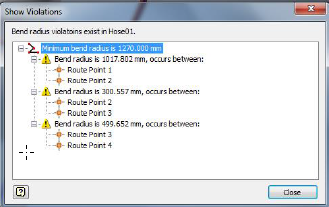

If there are any violations, the Show Violations dialog box displays. An icon displays next to a hose to indicate violations.

Use Bend Radius Check to check for bends that violate the specified Minimum bend radius. You can run a bend radius check on a selected flexible hose route. An icon is displayed beside the route in the browser if violations are detected.
