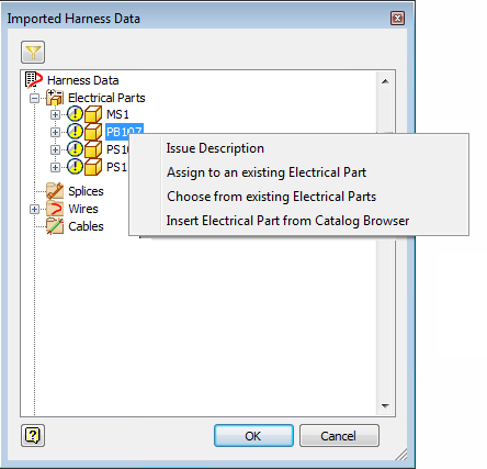

  3. Click Cable and Harness tab Manage panel Import Harness Data.
  4. Browse to an XML file exported from AutoCAD Electrical.
  5. Expand Electrical Parts and select an electrical part on the Imported Harness Data dialog box.
  6. Right-click and select Insert Electrical Part from Catalog Browser.

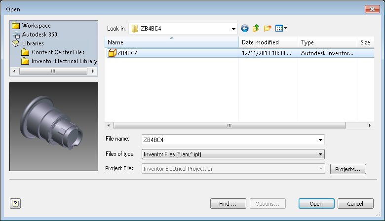

    • Click a part on the small palette.
    • If the part you want is not available on the palette, browse to locate the part on disk.

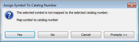

  9. If the part is not already associated to that catalog value, select whether to map the symbol.

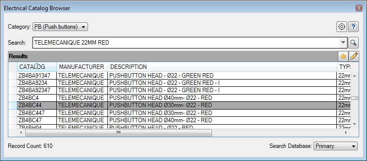

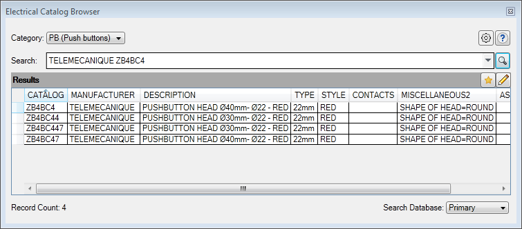

  2. Select the category for the type of part you want to insert.
  3. Enter a search criteria and click .
  4. Click the catalog value on the Electrical Catalog Browser and a small palette appears. If there are any parts associated to the catalog value they are shown on the palette.

  6. If the part is not already associated to that catalog value, select whether to map the symbol.

  8. Click Cable and Harness tabManage panelImport Harness Data.
  9. Browse to an XML file exported from AutoCAD Electrical.
  10. Select an electrical part on the Imported Harness Data dialog box.
  11. ight-click and select Assign to an existing Electrical Part.
  12. Select the previously inserted part.
