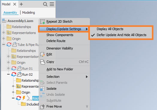

The following image shows the display settings you can access from the route's context menu.
Display All Objects
Allows the entire pipe run or specified routes to update. When the Display All Objects option is selected, the associated routes and runs are displayed as populated and automatically respond to changes. This setting is the default when new routes and runs are added to a primary runs assembly.
Defer Update and Hide All Objects
Defers automatic updates for the entire pipe run or specified routes. When the Defer Update and Hide All Objects option is selected, the associated routes and runs display as centerlines. Underlying components are hidden and do not respond to changes.
The deferred route is indicated by a lightning icon in the browser.
Note: Enable Display All Objects to display a route as populated. Enable Defer Updates and Hide All Objects to display a route as lines.
