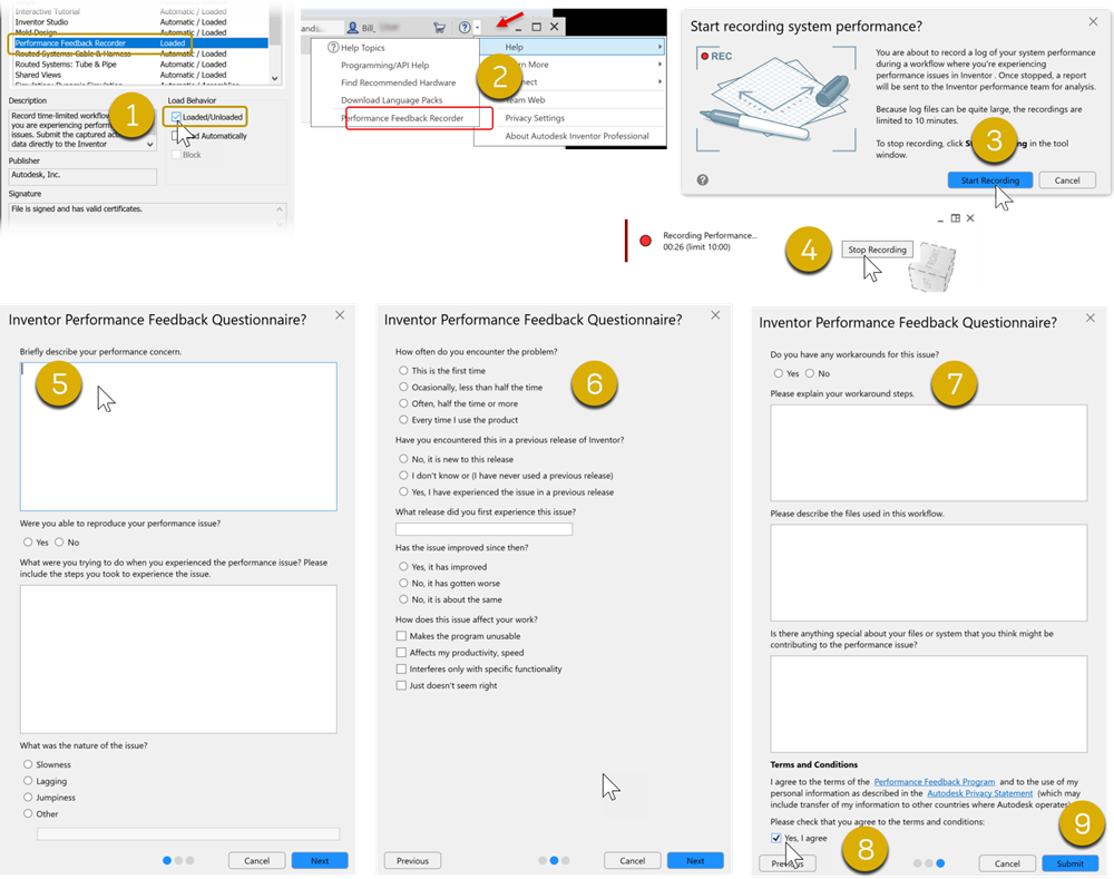

To Use the Performance Feedback Recorder
With the Performance Feedback Recorder loaded, you can activate the recorder and demonstrate a performance issue and then turn that information in to the Performance team for review and .
What's New: 2025
Manage the add-in
Access: In the Ribbon
Tools tab
Options panel, click Add-ins.
The recorder has a 10 minute time limit.
- In the Add-ins dialog, select Performance Feedback Recorder and under Load Behavior, click Loaded/Unloaded.
- In the Inventor Title bar, expand Help and click Help
Performance Feedback Recorder. The tool displays.
- In the recorder, click Start Recording.
- When you've demonstrated how you encountered the issue, then, click Stop Recording.
- In the Questionnaire, provide a brief description of the concern and the experience information.
- Select the appropriate input to describe the frequency, Inventor release used, and some scope information.
- Provide any workarounds you developed or had to do to get beyond the concern.
- Read the Terms and Conditions, check the box if you agree. The Submit button enables.
- Click Submit and the information you provided and the diagnostic files are sent to the Performance Team.
