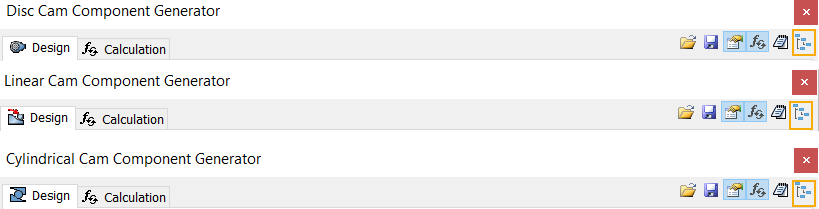

By default, parts are created at the root level of the assembly . To create parts in a sub-assembly, click the toggle.
