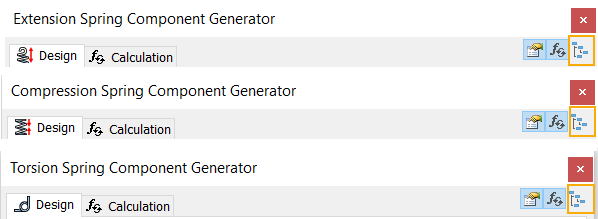

Design compression springs
By default, parts are created at the root level of the assembly . To create parts in a sub-assembly, click the toggle.
Insert compression springs
  1. On the ribbon, click Design tab Spring panel Compression .
  2. On the Design tab:
    • Specify the axis and start plane to place the compression spring.
    • Input other design values, for example, the wire diameter.
  3. Click Calculate to perform the calculation.
  4. The calculation results are displayed in the Results area. The inputs that fail the calculation are displayed in red (their value does not correspond with other inserted values or calculation criteria). The description of calculation results is displayed in the Summary of Messages area which is displayed after clicking on the chevron in the right lower part of the Design and Calculation tabs.
  5. Click OK to insert a spring to the Autodesk Inventor assembly.
Note: You can switch to the Calculation tab to enter the calculation values. For example, select the type of strength calculation and set the loads and spring material.
Tip: Click Results to display the HTML report.
