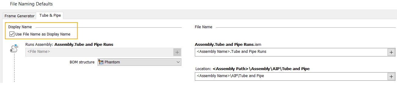

Specify how Tube & Pipe creates files and folders.
To use the file name for the name of the browser node: Select Use File Name as Display Name.
To configure a naming scheme for each type: Click the plus sign
next to each type and make a selection. Click the plus sign again to add additional folders.

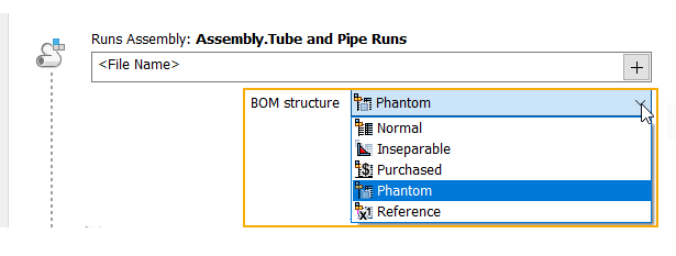

To specify a Bill of Materials structure type: Click the BOM structure drop-down arrow and make a selection.
