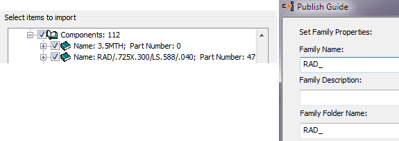

Do not include the following symbols in an IDF component name. An IDF component name containing one of the symbols below cannot be published to the IDF Content Center library. \, /, :, *, ?, “, <, >, |The Publishing wizard doesn't accept slashes in component names as well as other symbols that are not supported by OS file names.
Ensure the original ECAD/PCB design creating the part names does not include the characters below so that after importing the file into Inventor, the IDF parts can easily be published to the Inventor IDF Content Center library. An IDF component name containing one of the symbols below cannot be published to the IDF Content Center library.
Note: If one or more of these characters exists in a component name in the IDF original dataset, replace the offending character with "" (underscore character) in the Family Name field when you publish the component to the IDF Content Center library. If you replace the illegal character with the "", in the Family Name field, the IDF component will be reused when you open the IDF dataset with this component name.

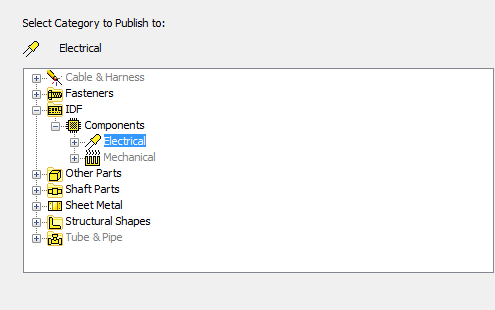

  7. In the next Publish Guide dialog box, the category the part is being authored to displays.
    If you select a different category you are warned the part will lose its authoring information.

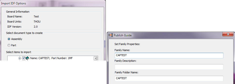

    Important: In the Publish Guide dialog box, you must add Part Number to the Key Column to successfully open the component Content Center when importing or opening an IDF file. Inventor uses the family name and the part number to locate the corresponding IDF component from Content Center library for placement.
  10. (Required) In the In the Publish Guide - Set Family Properties: Edit the Family name so that only the component name displays in the Family Name field. For example:
  11. In the Set Family Thumbnail image Publish Guide dialog box, click Publish.
