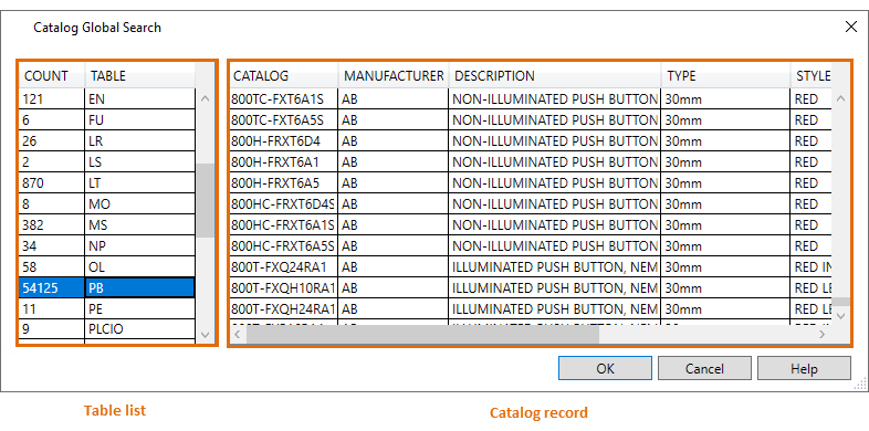

Catalog Global Search Dialog Box
Displays the catalog values search results based on a catalog search from the Catalog Browser.
Table List
Displays a list of the tables, and the number of records in the table, containing the catalog value. Select a table to display the records within that table that match the search value.
Catalog Record
Displays the catalog records in the selected table that match the search value. Click a column heading to sort the records based on the values in that column.Note: Sub-assembly items, as defined by an ASSEMBLYLIST value, are included in the search results. The global search results are based from the Catalog, Manufacturer, and Assembly Code column records.
OK
Assigns the selected catalog value to the component on the Catalog Browser.
