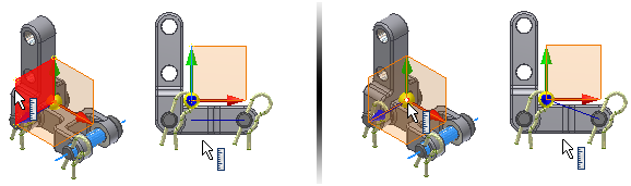

Select the center of gravity
The center of gravity symbol contains three selectable work planes and a selectable work point. Select the work planes to measure distance along the perpendicular axis. Use the work point to measure straight line distance.
- Start the measure command.
- Select a COG work plane and appropriate component geometry to measure perpendicular axial distance between geometry and selected plane.
- Select the COG work point and appropriate component geometry to measure straight line distance between geometry and COG work point.
