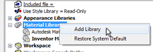

Step 2: Add the custom library to the project.
  1. Select the project to which you will add the library.
  2. Right-click the Material Libraries node and click Add Library.
  3. Navigate to and select the custom library you want to add to the project. Click OK.
  4. To make the added library the active library, the first one searched or referenced, right click the library node and click Active Library.

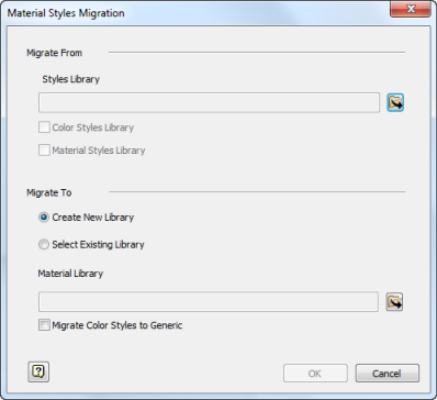

  3. In the browser toolbar, click Migrate Inventor Styles.
  4. In the Material Styles Migration dialog box, specify the Migrate From location which where the InventorMaterialLibrary.adsklib or a custom library file resides. By default the path is C:\Users\Public\Documents\Autodesk\Inventor [version]\Design Data\Materials.
  5. Specify the Migrate To location which is typically the InventorMaterialsLibrary.adsk file or a custom library you create. By default the path is C:\Users\Public\Documents\Autodesk\Inventor [version]\Design Data\Materials.
  6. Close and reopen the Material Browser.

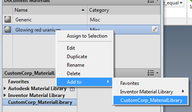

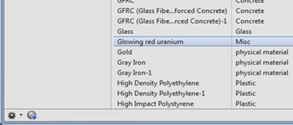

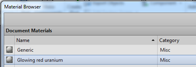

  7. In the Style Editor, click Done. The style is imported into the current document and is located in the Document Appearances.
  8. Open the Material Browser and in Document Materials, you will see the material. It is not yet in a library for use with other components.
  9. Drag and drop the imported appearance into the custom library. Alternatively, right-click the appearance and in the Add to list, select the library where the appearance will be stored.
