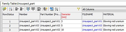

In the context of the first step, we will describe two scenarios used in migrating custom content center materials. In the first scenario assume that a Content Center family defined in a desktop content file called Mylibrary.idcl. The library uses a custom material called "Glowing red uranium".

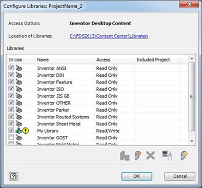

  1. Keep the project file open and add the custom content center library by clicking on the lower right icon in the editor.
  2. The library will be flagged as out-of-date displaying a yellow exclamation mark.
  3. Click the Update button at the lower right.
