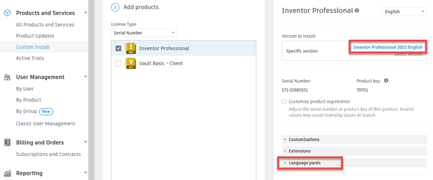

Navigate to the Custom Install in the left pane, select the Inventor release version, expand the Language packs drop-down, and select the language packs to be installed.

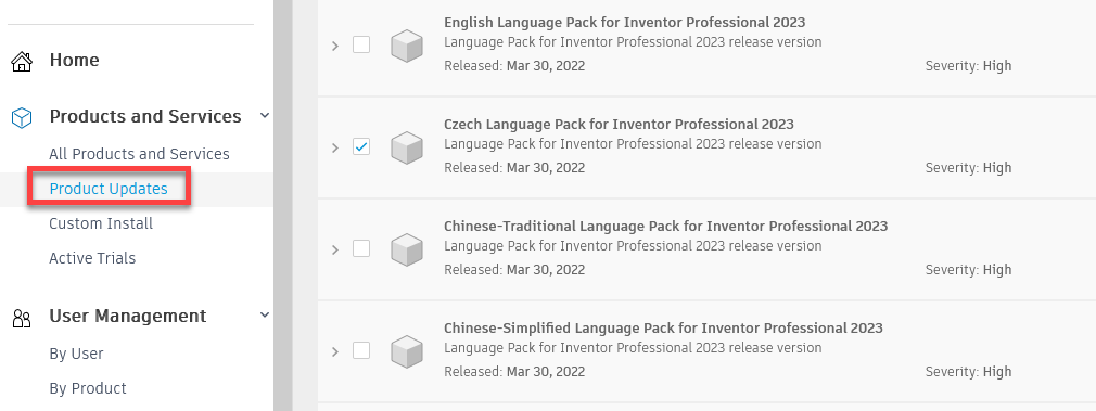

Or, navigate to the Product Updates in the left pane, and select the language packs to be installed.
