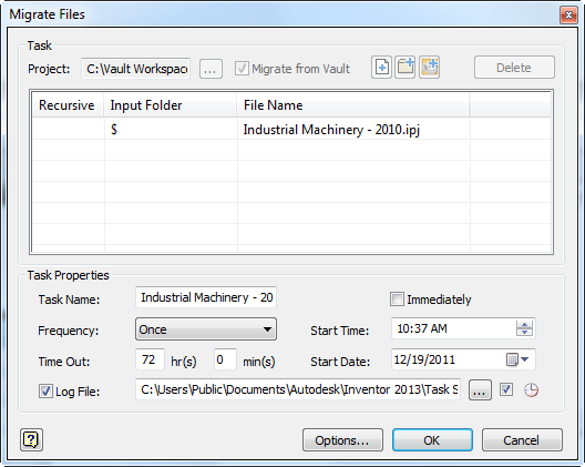

  3. On the Create Task drop-down menu, click Migrate Files….. In the Migrate Files dialog box, click Project Setting to select a Vault project, or click Browser... to select a vault project. Then add the project or folder or part to migrate. Recommend Add Project to migrate.
    Note: Ensure that Migrate from Vault is selected.
  4. In Task Properties:
    • Select Immediately to migrate the project files at once.
    • You can defer the migration until a later time, such as after-hours when Inventor is not in use. Set a time and date in the corresponding text boxes.
    • Set the Log File name and location
  5. Click Options… For optimal performance, it is best practice not to create visualization attachments as part of the migration. If you use Vault Professional , you can use a job processor to update visualization attachments later. For best results, temporarily modify settings Visualization Management to retain existing dwf files.
    Retain local copies of the files until after all migration is complete. It is best practice to add a comment so that later, you can identify each new version of the files as migrated successfully.
  6. Click OK to migrate files.
