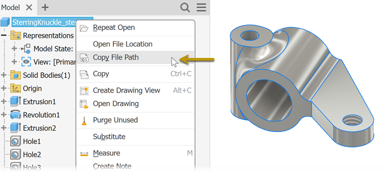

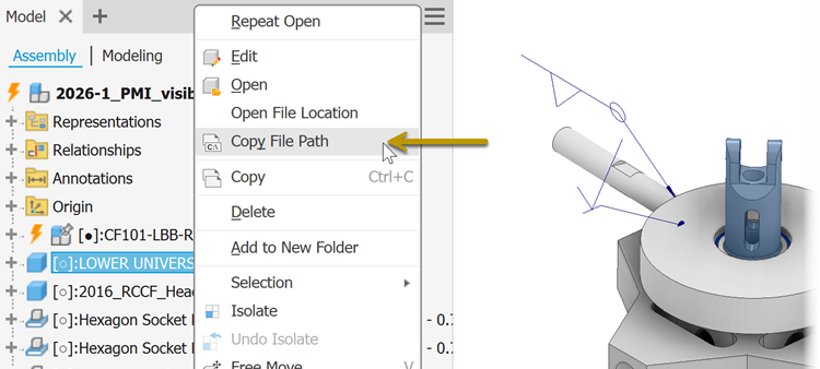

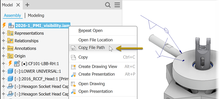

The right-click menu for any part or assembly file now includes the Copy File Path command. This provides an easy method for using a component's file path to access other files in the same path.
Including parts within an assembly

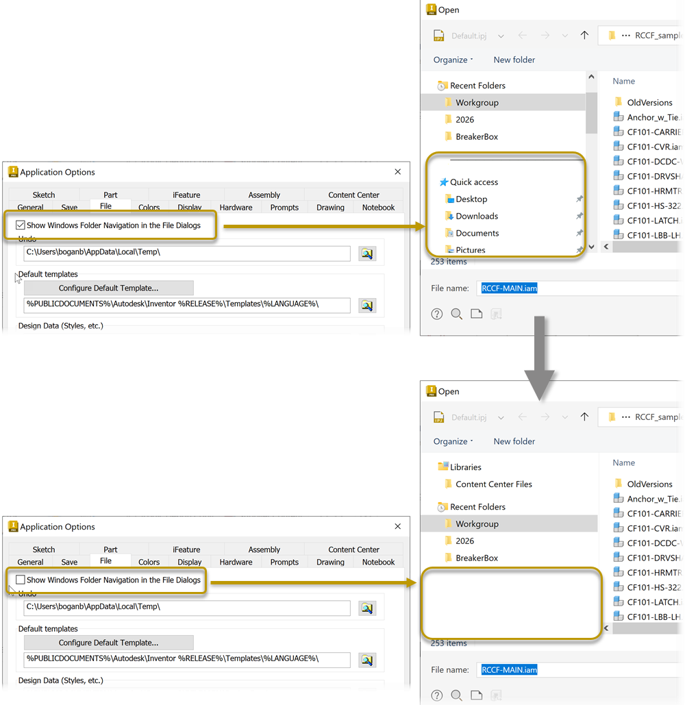

You can now control the display of the windows navigation section within the Open dialog with the new Application Options > Files tab setting Show Windows Folder Navigation in the File Dialogs.
For more information see To Open or Import a File.
