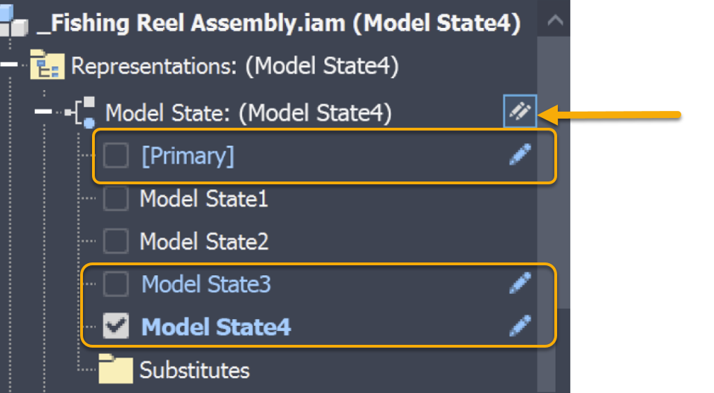

Update Model State text color to blue when being edited
Previously, it was difficult to quickly see which model states were being edited by viewing the text. Now, the model state being edited is shown in blue. Note that this change applies only to model states and will not affect iComponents, Views, or Positions.

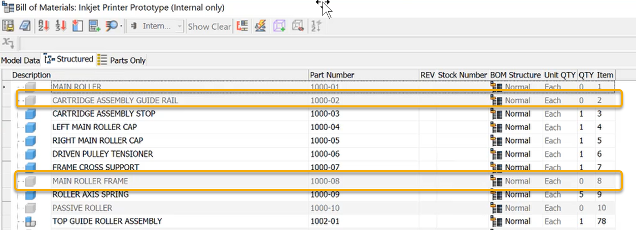

Updated BOM style to see 0 quantity elements
It is now easier to distinguish items with a quantity of zero in the Bill of Materials. The background color for rows with a quantity of zero is different from that of other rows.

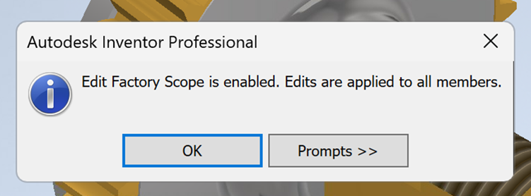

Removed alert when entering factory scope for model states
The warning message that was displayed when switching the model state to a Factory Scope is now removed.
Model States Warning
