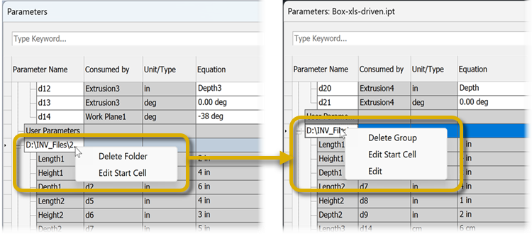

Parameter Enhancements
From the Parameters dialog you can now:
For more information see To Link Numeric Parameters from a Spreadsheet and To Link Numeric Parameters Between Files
