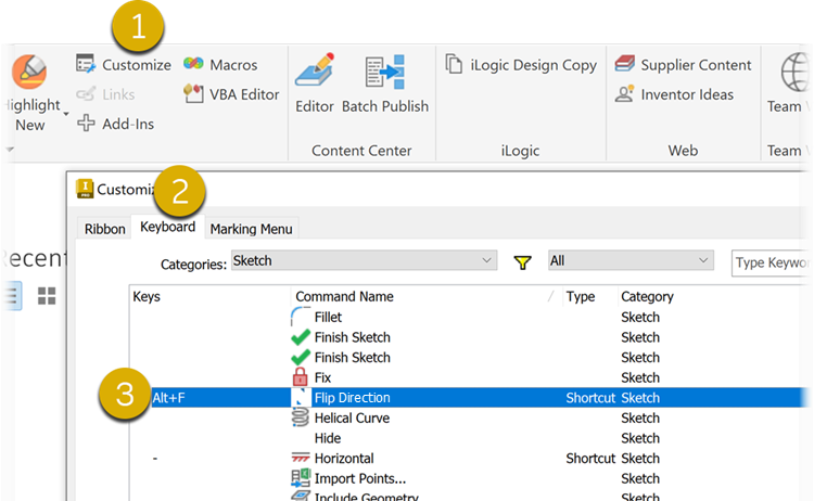

Customization
You can now add a shortcut for Flip Direction, added in 2026.1, to the Sketch environment using the Customize command.
Flip Dimension shortcut
For more information see To Work with Custom Command Aliases and Shortcuts.
