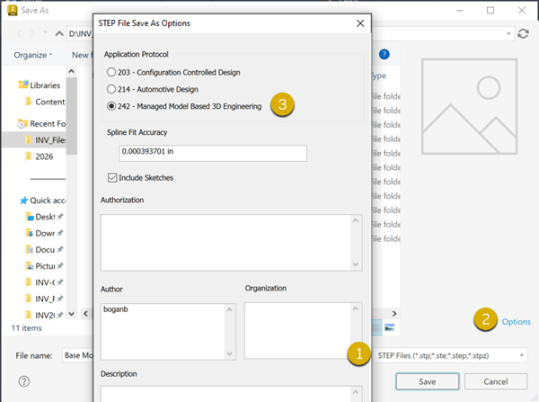

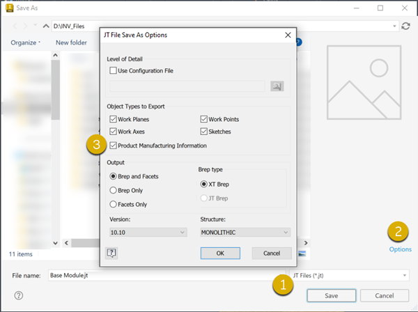

Product Manufacturing Information (PMI)
PMI can be included when exporting top level assemblies in JT and STEP formats.
