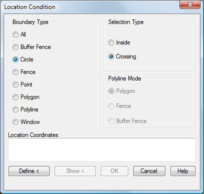

- Click Location.
- In the Location Condition dialog box, do the following:
- Under Boundary Type, select Circle.
- Under Selection Type, make sure Crossing is selected.
Objects that cross the circle you draw are added to the drawing.
- Click Define.
- Click in the center of the drawing and drag your cursor to draw a circle, as indicated in the following illustration.
Define the circle for the selection.
