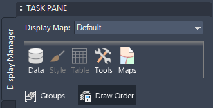

Layers in the map are displayed in the order in which they appear in the Display Manager draw order view: layers higher in the list are drawn in front of layers lower down.
Change the Order of Layers
  1. In Display Manager, make sure Draw Order is selected.
  2. Do one of the following:
    • Click the layer you want to move and then drag the layer up or down the list.
    • Right-click the layer and choose Move to Top or Move to Bottom.
  3. Drawing objects from layers higher in the list are displayed on top of drawing objects from layers lower in the list.
