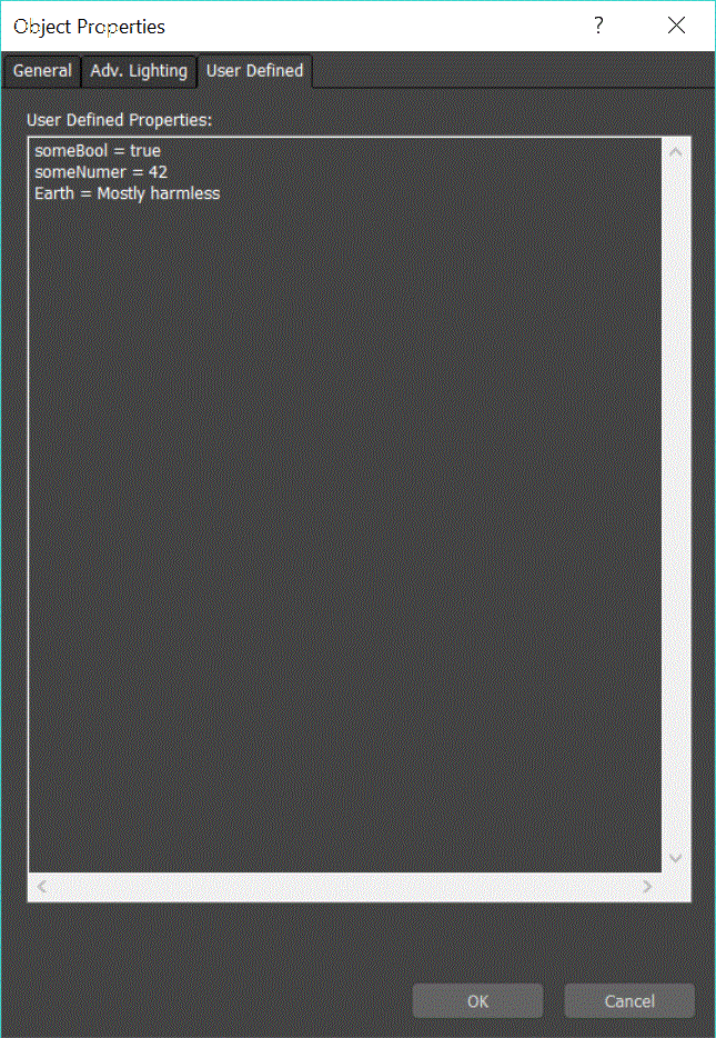

The functions described in this topic give you access to scene object user properties, accessible in the 3ds Max user interface in the User Defined tab in the Object Properties Dialog.
There are two sets of MAXScript methods for setting and getting individual keyed properties, and two methods that let you treat the property text as a single big string. The user defined properties in the Object Properties dialog are accessed as one single string representing the entire contents or as key/property pairs in the form:
<key1> = <property1><key2> = <property2>...where, the keys are identifiers (Name or String values, though Names are not recommended, see the note below) and the properties can be values. For the old methods, these can be numbers, booleans, or text strings. For the new methods, any value where (val==execute(val as string)) is true can be used.
