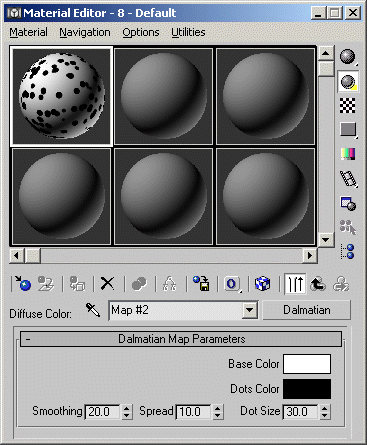

The following example shows how to extend an existing texture map plug-in. You can reduce the number of exposed UI elements and link some of them together in a logical way to achieve a new look.
The same effect can be easily achieved using a normal Cellular procedural map with the right settings, but a new interface greatly simplifies the task for the end user.

)--end pluginEvaluate the script. A new Dalmatian map appears in the Material/Map browser. You can use it anywhere a regular texture map is used. The default look is like of a typical Dalmatian dog’s skin.
