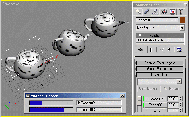

The Morpher modifier in 3ds Max provides up to 100 morph channels, but only 10 of them are visible at a time and can be controlled only using a value spinner. Using MAXScript, we will add a very basic floating UI extension to the Morpher modifier representing and controlling the Morpher channels using progress bars.
The script will also demonstrate the dynamic creation of UI elements by a script and the usage of time and change callbacks to react to time and properties changes.

)--end scriptEvaluate the script. To use it, you can use Customize... to drag the script from the category "HowTo" to a toolbar, a menu, a quad menu or to assign to a keyboard shortcut.
Select a single object with a Morpher modifier and some active channels in the scene and execute the script. A new floating dialog should appear showing a progress bar and a text field displaying the channel number and the target name.
