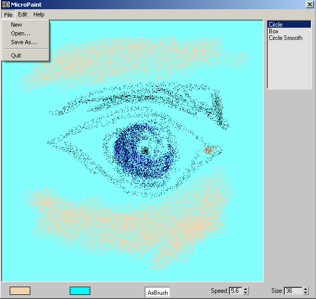

In this step of the Bitmap Painting tool development, we will add a main menu bar with New, Open, and Save options.
NATURAL LANGUAGE
We will define a new right-click menu with some menu items and corresponding event handlers.
We will assign the right-click menu as menu bar to the dialog.

local theBackgroundBitmap = bitmap bitmapX bitmapY color:white We will define a second bitmap called background. It will not be used now, but will be needed in the next tutorial to allow for an eraser function.
local currentPos = lastPos = [0,0]
rcMenu CanvasMenu (This is a right-click menu definition.
subMenu "File" (The first item in the menu will be called File. A typical program implements File, Edit, and Help items in its main menu, so we will define these too.
menuItem new_menu "New"
menuItem open_menu "Open..."
menuItem save_as "Save As..."Inside the File menu, we will add some menu items to start a new drawing, open an existing one, and save the results to a file on disk.
separator file_menu_1This is a separator that draws a horizontal line between the menu items.
menuItem quit_tool "Quit" This menu item will be used to quit the tool.
subMenu "Edit" ( )We will leave the Edit menu empty for now.
subMenu "Help"
menuItem about_tool "About MicroPaint..."
)The Help menu will contain only the about item.
on new_menu picked do
(This is the event handler of the File > New menu item. If the user selected it from the menu,
theBackgroundBitmap = theCanvasBitmap = bitmap bitmapX bitmapY color:MicroPaint_CanvasRollout.paperColor.colorwe will define a new bitmap using the new paper color (background color) added to the User Interface, and will assign to the painting canvas and the new background bitmap.
MicroPaint_CanvasRollout.theCanvas.bitmap = theCanvasBitmapThen, we assign the result to the User Interface bitmap.
on open_menu picked do
(This is the event handler of the File > Open menu item. If the user selected it from the menu,
theOpenBitmap= selectBitmap()we open the standard Bitmap picker dialog of 3dsmax. It provides options to preview all supported file formats.
if theOpenBitmap != undefined do
(If the user picked a valid bitmap and did not cancel out,
copy theOpenBitmap theCanvasBitmapwe copy the bitmap that was opened into the painting canvas,
copy theOpenBitmap theBackgroundBitmapand into the background bitmap. The copy method resizes the original to fit the size of the canvas.
close theOpenBitmapFinally, we close the opened bitmap,
MicroPaint_CanvasRollout.theCanvas.bitmap = theCanvasBitmapand assign the painting canvas to the User Interface bitmap.
on save_as picked do
(This is the event handler of the File > Save As menu item. If the user selected it from the menu,
theSaveName = getSaveFileName types:"BMP (*.bmp)|*.bmp|Targa (*.tga)|*.tga|JPEG (*.jpg)|*.jpg"we open the standard file saving dialog of 3ds Max and provide a list of some file extensions. You can add any supported file formats such as, RLA, RPF, and so on to this list.
if theSaveName != undefined do
(If the user specified a valid name and did not cancel out,
theCanvasBitmap.filename = theSaveNamewe set the file name of the painting canvas to the selected name,
save theCanvasBitmapand save the bitmap to disk.
on about_tool picked do messagebox "MicroPaint\nMAXScript Tutorial" title:"About..."If the user picked the Help > About menu item, we open a message box with some text. You can add your own text to this dialog with version number and others.
on quit_tool picked do destroyDialog MicroPaint_CanvasRolloutIf the user picked the File > Quit menu item, we destroy the dialog. Later, we can add a prompt whether the current painting can be saved to disk.
