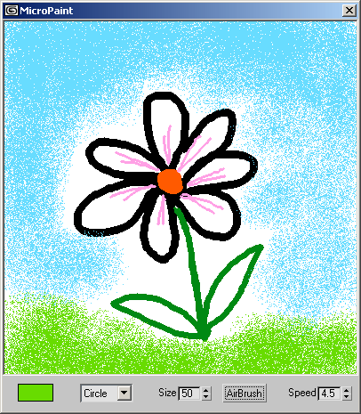

In this step of the Bitmap Painting tool development, we will add an airbrush option to the tool and a brush shape option to draw both rectangular and circular brushes.
NATURAL LANGUAGE
The existing rollout will be enhanced by adding a dropdown list to define the Brush shape, a checkbutton to enable the AirBrush, and a spinner to control its strength.
We will extend the existing code by drawing random points for the AirBrush option.
The drawStroke function will be enhanced to draw a circle with the Size as the radius.

bitmap theCanvas pos:[0,0] width:bitmapX height:bitmapY bitmap:theCanvasBitmap colorpicker inkColor height:16 modal:false color:black across:4 To accommodate automatically all new controls in the bottom row, we will have to increase the across: parameter to 4.
checkbutton airBrush "AirBrush" width:50When checked, this checkbutton will enable the Airbrush feature.
spinner AirBrushSpeed "Speed" range:[0.1,50,10] fieldwidth:40This value will control the strength of the Airbrush feature.
spinner BrushSize "Size" range:[1,50,10] type:#integer fieldwidth:40 listbox BrushShape items:#("Circle", "Box") width:90 pos:[bitmapx+5,0]This listbox controls the shape of the brush. In the future versions, we will add additional tools to it.

( if airBrush.checked then (When the Airbrush option is checked, the following code will be executed:
for b = 1 to (BrushSize.value / AirBrushSpeed.value) doWe will repeat a number of times. The actual number will be dependent on the size of the brush and the Airbrush speed value. The higher the Speed value, the lower the number of samples in the brush.
paintBrush (currentPos + (random [-BrushSize.value/2,-BrushSize.value/2] [BrushSize.value/2,BrushSize.value/2] ))For every iteration, we will draw a random point between the lower left and upper right corners of the box brush. If circular brush is selected, some of the points will be filtered out by the new code in the paintbrush function above.

)Result
