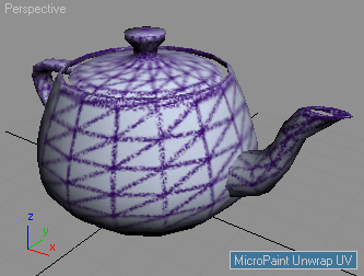

We will add a new function to read the UV coordinates from a selected mesh and draw strokes in the painting based on the vertex positions in texture space.
We will define a default temp. file name for the painting and will optionally save it after each stroke.

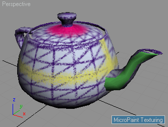

We will assign the temp. disk copy of the bitmap to the diffuse channel of the picked object.

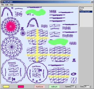

We will add a new checkbox to the User Interface to enable and disable autosaving. When enabled, the bitmap will update in realtime as we paint in our tool.

rollout MicroPaint_CanvasRollout "MicroPaint"
bitmap theCanvas pos:[0,0] width:bitmapX height:bitmapY bitmap:theCanvasBitmap
colorpicker inkColor height:16 modal:false color:black across:6
colorpicker paperColor height:16 modal:false color:white
checkbutton autoSave "AutoSave" width:70
checkbutton airBrush "AirBrush" width:70
spinner AirBrushSpeed "Speed" range:[0.1,50,10] fieldwidth:30
spinner BrushSize "Size" range:[1,50,1] type:#integer fieldwidth:40
listbox BrushShape items:#("Circle","Box","Circle Smooth") pos:[bitmapX+5,0] width:90

pickbutton pickMesh "Pick Mesh" width:90 height:30 pos:[bitmapX+5,140] filter:mesh_filter autodisplay:true
on pickMesh picked obj do
if obj != undefined do
theObj = Obj
try
copy theObj.material.diffusemap.bitmap theCanvasBitmap
copy theObj.material.diffusemap.bitmap theBackgroundBitmap
theCanvas.bitmap = theCanvasBitmap
)catch()

fn unwrapTexture =
if theObj != undefined then
theMesh = snapshotAsMesh theObj
if meshop.getMapSupport theMesh theChannel do
faceCount = meshop.getNumMapFaces theMesh theChannel
for f = 1 to faceCount do
theFace = meshop.getMapFace theMesh theChannel f
vert1= meshop.getMapVert theMesh theChannel theFace.x
vert2= meshop.getMapVert theMesh theChannel theFace.y
vert3= meshop.getMapVert theMesh theChannel theFace.z
drawStroke [vert1.x * bitmapx_1, bitmapy_1 - vert1.y * bitmapy_1] [vert2.x * bitmapx_1, bitmapy_1 - vert2.y * bitmapy_1] drawIt:false
drawStroke [vert1.x * bitmapx_1, bitmapy_1 - vert1.y * bitmapy_1] [vert3.x * bitmapx_1, bitmapy_1 - vert3.y * bitmapy_1] drawIt:false
drawStroke [vert3.x * bitmapx_1, bitmapy_1 - vert3.y * bitmapy_1] [vert2.x * bitmapx, bitmapy_1 - vert2.y * bitmapy_1] drawIt:false
save theCanvasBitmap
if theObj.material == undefined do theObj.material = Standard()
if theObj.material.diffusemap == undefined do
theObj.material.diffusemap = bitmapTexture filename:temp_bitmap_filename
showTextureMap theObj.material true
autoSave.checked = true
--NEW UNWRAP TEXTURE FUNCTION ENDS HERE

) RESULT:
In this example, Unwrap UVW modifier is applied to a teapot and the Flatten function is used to create the new texture coordinates.
Then, the object is selected in MicroPaint and the texture coordinates are drawn using the Circular Smooth brush with size 5, Airbrush turned on, and Airbrush Speed set to 1.0.
This is the teapot as seen in the viewport:
Now, you can start painting on top of the UV coordinates using all available brushes - as long as the AutoSave button is checked, all your strokes must update in the viewports:
