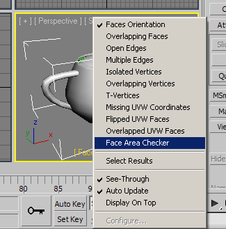

At this point, we can evaluate the code by pressing Ctrl+E and use the xView checker, but it will not be visible in the Viewport Menus yet.
To see the new checker, enable any other xView checker like for example Face Orientation, then click on the [Face Orientation] label at the bottom of the viewport to display the list of registered checkers. The Face Area Checker should appear there.
Select it from the list to enable it.
The label [ Face Area Checker ] will be displayed at the bottom of the screen and if a valid object (Editable Mesh or Editable Poly) is selected, the faces/polygons will be tested and shaded in the viewport.
To configure the Min. and Max. Thresholds, click on the [ Click Here To Configure ] label.
To make the checker available in future 3ds Max sessions without the need to evaluate the script manually, copy the script to the \Startup folder or any folder registered as a plugin path OR its sub-folders.
