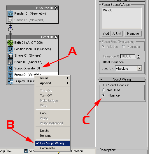

PARTICLE VIEW SETUP :
The Particle View setup features a Scale operator that defines variable sizes for the particles.
To get the Script Wiring, you have to do the following:
