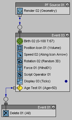

Create a Particle Flow with Birth operator generating particles from start to end frame at the rate of 20.0.
Use Speed operator to accelerate the particles up. Use some variation to get a more random look.
Set the Display to Geometry.
Add an AgeTest to kill the particles after 50 frames. Wire to a Delete operator in a separate event.
Add a Force and some Wind if you want more motion.
To get the scene working completely, assign a Fire Effect in the Environment dialog and assign ALL 30 SphereGizmos to it. Play with the color settings, density, and others to get the look you want.
Create a Teapot and place the Particle Flow at the spout to get the steam coming out of the right place.
SCRIPT OPERATOR CODE:
