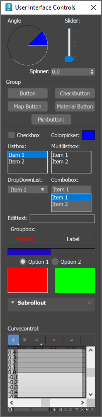

The following script was used to create the rollout image above:
EXAMPLE SCRIPT:
try(destroyDialog allControls )catch()
rollout subRollout1 "Subrollout" ( )
    rollout allControls "User Interface Controls" (
    angle theAngle "Angle" width:80 across:2 degrees:45 align:#left
    slider theSlider "Slider:" orient:#vertical
    spinner theSpinner "Spinner:"
    group "Group" (
    button theButton "Button" across:2 width:80 align:#left
    checkbutton theCheckbutton "Checkbutton" width:80 align:#right
    mapbutton theMapButton "Map Button" width:80 across:2 align:#left
    materialbutton theMatButton "Material Button" width:80 align:#right
    pickbutton thePickbutton "Pickbutton:" width:80)
    checkbox theCheckbox "Checkbox" across:2 offset:[0,2]
    colorpicker theColorpicker "Colorpicker:"
    listbox theListbox "Listbox:" items:#("Item 1","Item 2")\
    height:3 width:80 across:2
    multilistbox theMLBox "Multilistbox:" items:#("Item 1","Item 2")\
    height:3 width:80
    dropdownlist theDDL "DropDownList:" items:#("Item 1","Item 2")\
    width:80 across:2
    combobox theCombobox "Combobox:" items:#("Item 1","Item 2")\
    height:3 width:80
    edittext theEdittext "Edittext:"
    hyperlink theHyperlink "Hyperlink" url:"http://www.autodesk.com"\
    color:red across:2 offset:[10,20]
    label theLabel "Label" offset:[0,20]
    groupBox theGroupbox "Groupbox:" height:40 offset:[0,-40] width:174
    progressbar theProgressbar "Progressbar:" value:50
    radiobuttons theRadiobuttons labels:#("Option 1","Option 2")
    bitmap theBitmap "Bitmap" width:80 height:50 offset:[0,0]\
    bitmap:(bitmap 80 50 color:red) align:#left across:2
    imgTag theImgTag "Bitmap" width:80 height:50 offset:[0,0]\
    bitmap:(bitmap 80 50 color:green) align:#right
    SubRollout theSubrollout "Subrollout" height:50
    curvecontrol theCurvecontrol "Curvecontrol:" height:150
createDialog allControls 200 800
AddSubRollout allControls.theSubrollout subRollout1
