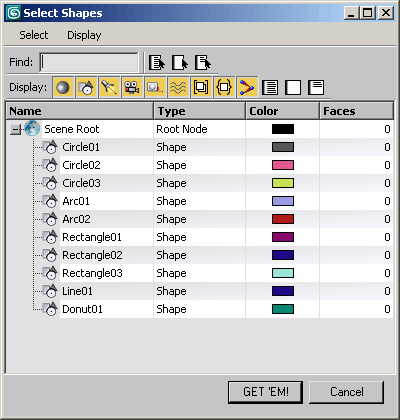

FOR EXAMPLE,
the following function limits the choices to shape objects:
fn shape_filt obj = isKindOf obj ShapeThen you can call the Select By Name function to select multiple shapes including hidden ones:
theShapes =selectByName title:"Select Shapes" buttonText:"GET 'EM!" filter:shape_filt showHidden:true single:falseRESULT:
If the user cancels out of the dialog, the function returns the value undefined .
