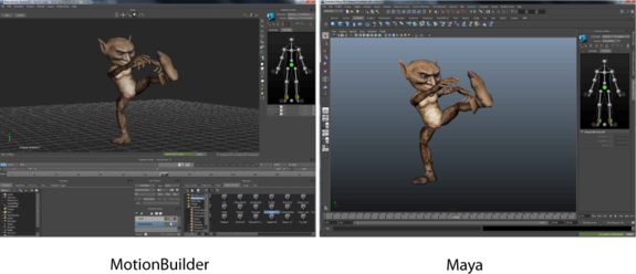

Use
Send to commands to transfer HumanIK character data between
Maya and MotionBuilder which means you don't need to export your characters from
Maya to FBX to import them into MotionBuilder.
Note: You can also use
Send to commands to send standard objects and animations, as well as HumanIK characters, to MotionBuilder.
