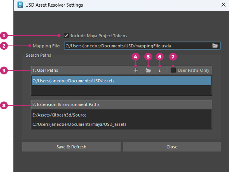

Asset Resolver Settings
To access the USD Asset Resolver Settings dialog, go to Windows > Settings/Preferences > Preferences > USD, then under Asset Resolver, click USD Asset Resolver Settings.
This dialog lets you manage how USD resolves asset paths in Maya. It defines where and how the resolver searches for assets, including project tokens, user-defined paths, and environment variables.
Note:
Asset Resolver is currently not available on MacOS.
  1. Include Maya Project Tokens: Enable this option to let the USD Asset Resolver use the directories defined in Maya’s project window as search tokens. When on, your current Maya project folders automatically become tokenized search locations.
  2. Mapping File: Specifies a mapping file that contains data used by the resolver, such as search paths and tokens. Use the Browse button to navigate and select the file. You can also create custom mapping files to match your specific environment setup.

  1. User Paths: Define your own custom search paths for the Asset Resolver.
  1. Add: Click the + button to add a new blank row where you can enter a custom search path.
  2. Add via Browse: Opens a file browser to select a directory and add it to the list. If multiple paths are selected, the Browse button is disabled.
  3. Move Up/Move Down: Reorder user-defined paths to control their search priority relative to extension and environment variable paths.
Important:
The order of search paths affects performance. Place paths that are used most often at the top of the list for faster resolution. Avoid using broad or root-level paths (for example, C:), as they can significantly slow down searches.
  1. User Paths Only: Enable this option to restrict the Asset Resolver to search only within user-defined paths. When on, paths from extensions and environment variables are ignored.
  2. Extensions & Environment Variables Paths: Lists paths added automatically through mapping file or environment variables. These entries are read-only and cannot be reordered, but you can copy them for reference. The Asset Resolver automatically gathers search paths from the following environment variables:
