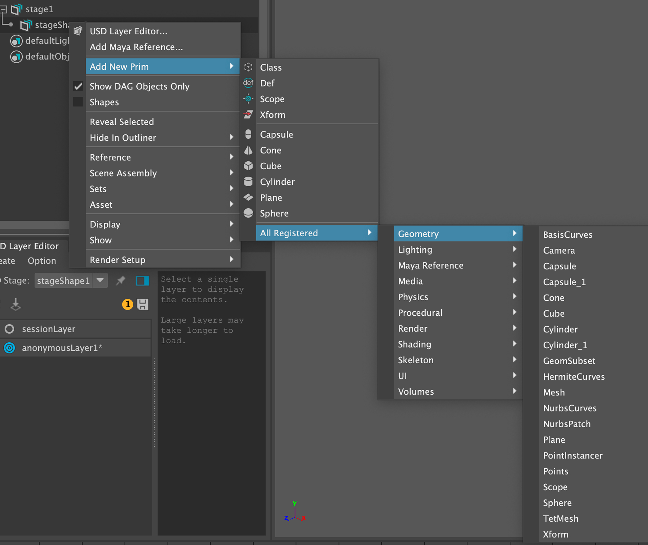

USD prim types in the Outliner
To differentiate between various prim types, USD data in Maya features a unique set of prim icons and composition arc badges that are viewable from the Outliner.
Prim Type Icon Index
Prim type icons in the Outliner are based on an inheritance schema, which allows the descendants of a prim to gain a parent prim's icon unless it has a unique icon created for itself.
Icon Prim Type Description
Class A special type of prim that acts as a template, storing reusable properties and values that can be inherited by other prims in a scene.
def A def is a type-less prim type. Since defs are empty and contain no information, they are used for defining references. A def can easily take on the prim type of the referenced prim, making it the ideal prim type for this scenario.
Scope A scope is a container that cannot be transformed. It is the simplest prim type and is useful for creating a hierarchical structure. For example, materials are typically held within a scope, because they do not need to be transformed.
Xform An Xform prim defines spatial transformations that can be used to translate, rotate and scale its child prims.
Capsule A prim shaped in the form of a capsule; a cylinder capped by two half spheres, centered at the origin, whose spine is along the specified axis.
Cone A prim shaped in the form of a cone; centered at the origin, whose spine is along the specified axis, with the apex of the cone pointing in the direction of the positive axis.
Cube A rectilinear prim shaped in the form of a cube, centered at the origin.
Cylinder A prim shaped in the form of a cylinder, centered at the origin, whose spine is along the specified axis.
Plane A prim that defines a flat 2D space.
Sphere A prim shaped in the form of a sphere centered at the origin.
BasisCurves
NurbsCurves
BasisCurves are a batched curve representation, often used to render geometry like hair or grass.
NurbsCurves are a spec that supports batching of multiple curves into a single prim, widths, and normals in the schema.
Mesh A point-based prim that is defined in terms of points that are connected into edges and faces.
NurbsPatch A non-uniform spline surface with natural UV parameters. This enables you to "trim curves" and allow smooth shapes to be carved out of a surface.
Points A base class for prims that possess points, such as normals and velocities.
Volume A renderable volume prim.
PointInstancer A vectorized instancing of multiple, potentially animated, prototypes (object/instances), which can be arbitrary prims/subtrees on a stage. PointInstancer is a "multi instancer", as it allows multiple prototypes to be scattered among its "points".
SkelRoot
Skeleton
A body and topology of a skeleton.
MayaReference
ALMayaReference
A Maya reference and all its metadata.
Camera A transformable (XFormable) camera.
CylinderLight
DiskLight
DistantLight
DomeLight
GeometryLight
RectLight
SphereLight
LightFilter
LightPortal
Lights can be linked to geometry. Linking controls which geometry a light illuminates, and which geometry casts shadows from the light.
GeomSubset Encodes a subset of a piece of geometry. To apply a subset to a prim, a GeomSubset prim must be defined as a child of it.
NodeGraph NodeGraph is a container for shading nodes, as well as other node-graphs.
Material A Material provides a container into which multiple "render targets" can add data that defines a "shading material" for a renderer.
Shader Shaders are the building blocks of shading networks. These objects generally represent a single shading object, whether it exists in the target renderer or not.
SkelAnimation
PackedJointAnimation
The animation of a skeleton.
BlendShape A target blend shape, possibly containing in between shapes.
Backdrop Provides a 'group-box' for the purpose of node graph organization.
someOtherType Generic fallback for usdTyped schemas.
