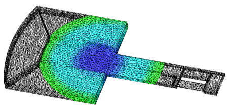

Drag the slider bar along until the time elapsed is about 1.5 seconds.
Click
(Results tab > Properties panel > Plot Properties). The Plot properties dialog appears. This allows you to edit the way the results are displayed.
Select the Mesh Display tab.
From the Edge display on undeformed part box, select Element lines.
From the Surface display box, select Transparent and leave the Opacity at the default value 0.1.
Select the Optional Settings tab from the top of the dialog box and change the Color option to Banded.
Click OK to view the result.

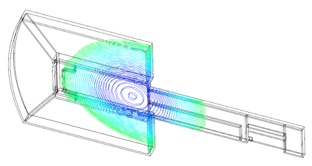

Drag the slider bar along until the time elapsed is again about 1.5 seconds.
Click
Plot Properties and select the Methods tab.
In the Selection box, click Contour and change the Number of contours to 50.
From the Mesh Display tab, select Feature lines from the Edge display on undeformed part box and increase the transparent opacity to 0.5 in the Surface display.
Click OK.

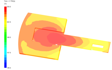

Select the Animation tab and from the Animate result over box, select Single dataset from the drop-down box. This allows us to select a single time within the cycle that we are interested in. From the Animate result at box, select the a time at approximately 2.8 seconds.
From the Scaling tab, enter 135 in Min and 225 in the Max text boxes.
Click OK.
The appearance of the model has changed. This is because the scale on the right of the screen has been automatically modified to represent the temperature range within this frame. Previously it accommodated the temperature range throughout the cycle.
Click
Step Backward several times.
Each step in the animation now represents a decrease in the temperature displayed. The description beside the slider bar now reads C (for Celsius). Previously it displayed s (for seconds).
The description at the top of the Model pane shows:
If you are interested in a specific value, you can use this value as a limit in the display. You will now find what portion of the model is above 160°C at about 2.8 seconds of the cycle.
Click
Plot Properties and select the Scaling tab.
Select the Specified option and enter 160 in the Min box and 225 in the Max box. Click OK.
Again the coloring of the model has altered to reflect the changed scale bar limits, and the gray area represents sections of the mold outside the colored temperature range shown at the specified time. Rotate the part to view rib section on the underside of the part.
