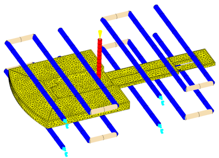

The tutorial model is shown in the image below:

(View tab > Navigate panel > Orbit) and rotate the model to examine its geometry and features. Notice in the Study Tasks pane that the tutorial model is represented by a Dual Domain Mesh. It contains one injection location and four cooling circuits.

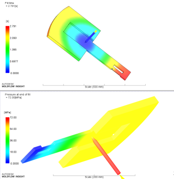

View multiple results:
Click
(View tab > Windows panel > Split > Split Horizontally). The screen is split and a duplicate of the model is displayed in the lower portion of the screen.
The split pane tools work as a toggle. Use the tool to turn the splits on and off. Turning a split off removes any specific formatting settings for that pane.
Click inside the lower pane. This is now the active pane.
Select Pressure at end of fill from the Results section of the Study Tasks pane.
Rotate and zoom in on a section of the model and note how the image in the upper pane has not altered. This allows you to view different results in different parts of the model.
With the bottom pane still active, select Fill time from the Results section of the Study Tasks pane. This allows you to view the same result in different parts of the model.

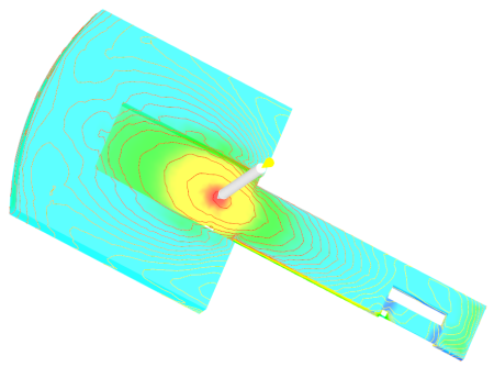

Results such as Volumetric shrinkage at ejection and Bulk temperature at end of fill , which are normally represented by solid shaded colors, cannot be overlayed.
Select Bulk temperature at end of fill . Right-click on the name in the Study Tasks pane and select Properties from the menu that appears.
The Plot Properties dialog appears. This dialog will be discussed in a later task.
Select the Methods tab from the top of the dialog.
Select the Contour option.
Enter 50 in the Number of contours text box and click OK.
The results are displayed in contours.
Right-click on Volumetric shrinkage at ejection and select Overlay. Rotate the model to investigate the result.
