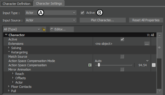

  4. From the Input Type and Input Source menus, select Actor (if it is not automatically selected).
  5. Turn on the Active option (if it is not already activated) to snap the character onto the Actor source.
    Character Settings pane A. Actor is selected as the Input Type B. Active option is enabled
