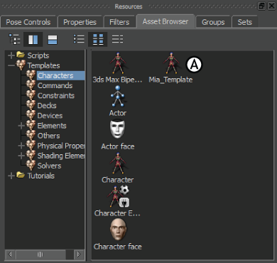

    The new template appears in the Asset browser > Character asset folder after you restart MotionBuilder.
    Characters folder A. Custom template
