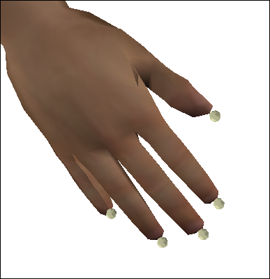

Toe Tips Sizes
Lets you adjust the size of each of the floor markers used to outline the toe tips for the left and right feet.
Unlike hand and foot contacts, the outer mesh of each toe tip marker defines the area that makes contact with the floor.
To view the toe tips on your model, select > Show/Hide > Finger Tips from the Character Controls window.
When you characterize your character, toe tips are automatically placed at the end of the model’s toes, specified by the last joint or bone. To ensure toe tips work properly, you must specify an end joint or bone as the last node in each toe.
See Finger and toe tips.
Right hand finger tips
