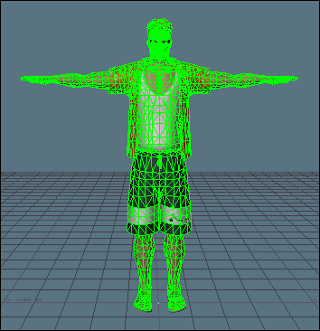

For all character models, the skeleton provides their underlying structure. The outer appearance of each model is created by a geometric skin (or mesh) on which textures, colors, facial and body features are applied to form the body of the character. It is the skin that gives a model its distinct appearance.
Geometric skin gives the model its outer appearance. Model is shown in a T-stance

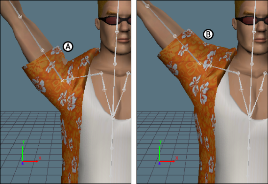

For example, in the following figure, A shows the shoulder mesh of the character deforms unnaturally as the shoulder is rotated on the Z-axis. B, in the following figure shows the same character with improved weighting on the shoulder vertices. The shoulder assumes a much more natural position as the shoulder is rotated on the Z-axis.
Mesh deformation A. Shoulder mesh deforms at an unnatural angle B. Shoulder mesh deforms naturally
