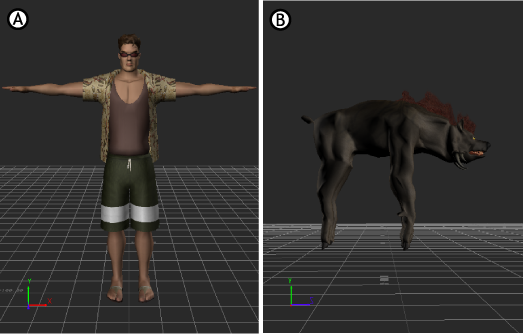

Before you characterize a model, it must be in a T-stance or rest pose, and it must be facing the positive Z-axis.
For biped models, the rest pose is a T-stance with all fingers and thumbs out straight. For quadrupeds, it is a stance where the four limbs in your model and all toes point towards the floor.
Stances A. Biped T-stance B. Quadruped stance
This stance is important because when you characterize a model, MotionBuilder takes the current pose of the model as the starting pose. All future movement is based on this starting pose.
