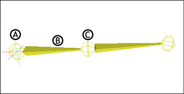

    Each time you click, another node (or bone) is added to the skeleton in a chain to create a limb. Each successive bone is parented to the preceding bone.
    A. Skeleton root B. Skeleton limb C. Skeleton node
