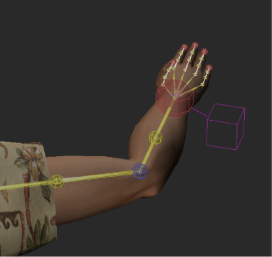

By default, an Auxiliary effector displays as a wireframe cube in the Viewer window. You can change the look, color, and size of Auxiliary effectors in the Properties window.
Auxiliary effector displays on a wrist effector

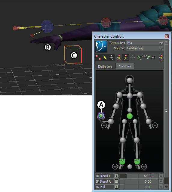

You can translate an Auxiliary effector to the position you want its corresponding IK effector to reach, then control the amount of reach between the IK effector and the Auxiliary effector using the IK Blend options . See also Blend and Pull controls for more information.
Adjusting Auxiliary reach A. Right wrist effector Auxiliary effector selected B. Hand reaches between IK effector and Auxiliary effector C. Auxiliary effector is translated away from right wrist
