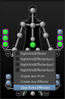

To delete all auxiliary pivots and auxiliary effectors for an effector in a Character in the Character Controls window:
  1. Right-click the IK cell.
  2. Select Clear Extra Effectors from the context menu.
