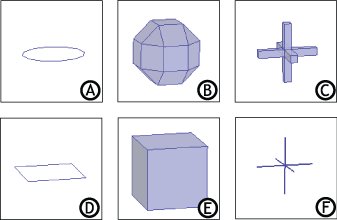

  2. In the Resources window > Properties tab > Marker Settings > Look drop-down list, select one of the following shapes:
    IK effector marker types A. Circle B. Sphere C. Hard Cross D. Square E. Cube F. Light Cross
Sphere is the default marker type.
The Hard Cross and Light Cross types display the markers as thick and wireframe crosses, respectively.
Selecting None hides all the effectors in a Character in the Viewer window.
