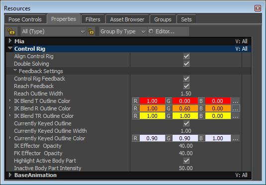

Feedback Settings
This group of properties lets you show, hide, and change the way visual feedback is displayed on the Control rig.
PropertyDescription
Control Rig FeedbackShows or hides all visual feedback elements on the Control rig.
Reach FeedbackShows or hides the Reach feedback outline that displays on effectors with Reach values defined.
Reach Outline WidthChanges the width of the outline that displays when an object has Translation Reach, Rotation Reach, or both values defined. When Reach is set to zero, no outline displays.
IK Blend T Outline ColorChanges the color of the outline that displays around objects with Translation Blend values defined. By default the IK Blend T Outline is red.
IK Blend R Outline ColorChanges the color of the outline that displays around objects with Rotation Blend values defined. By default, the IK Blend R Outline is orange.
IK Blend TR Outline ColorChanges the color of the outline that displays around objects with Rotation and Translation Blend values defined. By default, the IK Blend TR Outline is yellow.
Currently Keyed OutlineShows or hides the pale blue outline that displays on effectors that are keyframed at the current time. You can change the color of this outline using the Currently Keyed Outline Color property.
Currently Keyed Outline WidthChanges the width of the outline on currently keyed objects in the Control rig. By default, the Currently Keyed Outline has a Width value of 1.
Currently Keyed Outline ColorChanges the color of the outline that displays on currently keyed objects in the Control rig. By default, the Currently Keyed Outline displays in light blue.
IK Effector OpacityChanges the opacity of IK effectors. By default, IK effectors have an opacity value of 40. When set to zero, the markers are wireframe. The higher the value, the more opaque the effectors become.
FK Effector OpacityChanges the opacity of FK effectors. By default, FK effectors have an opacity value of 40. When set to zero, the markers are wireframe. The higher the value, the more opaque the effectors become.
Highlight Active Body PartWhen activated, active body parts are highlighted and inactive body parts are faded. When disabled, the entire Control rig displays with uniform highlighting. You can change the level of intensity on inactive effectors using the Inactive Body Part Intensity property.
Inactive Body Part IntensityAdjusts the intensity of color for inactive body parts. When you are in Body Part keying mode, all effectors that are not part of the selected body part display with faded coloring. This property lets you adjust the level of fading on those inactive body part effectors.
