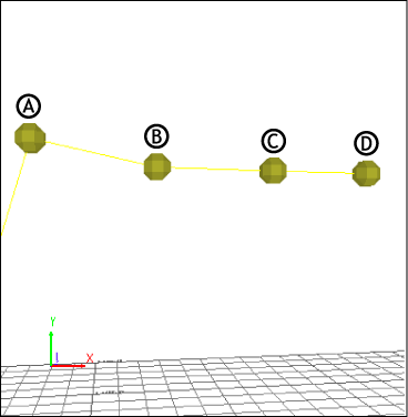

The easiest way to explain this rule is to compare it to a simple chain. The following figure uses four joints to represent an arm.
Arm FK chain A. Shoulder or root joint B. Elbow joint C. Wrist joint D. Hand or end joint
In the arm FK chain, rotation of the shoulder joint (A) is propagated down through the elbow (B) and wrist (C) to the hand (D). If only the elbow (B) is rotated, only the wrist (C) and hand (D) move, but not the shoulder (A). In other words, the joints in an FK chain have a parent-child relationship in which the child node (B) follows the behavior of the parent node (A). Usually, the animator must define these complex rules for all of the joint motions on a character, but in MotionBuilder, the work is done for you by the Control rig.

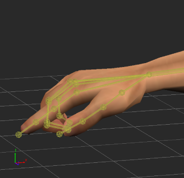

For example, the following figure shows FK effectors on each finger of a character in MotionBuilder. These effectors were translated and rotated to close the hand, something that would not have been possible with IK.
FK lets you manipulate individual joints such as those in the fingers.
Thus, one of the features of FK is that it gives you complete control over individual bones in the skeleton, letting you manually position each individual joint in a chain.

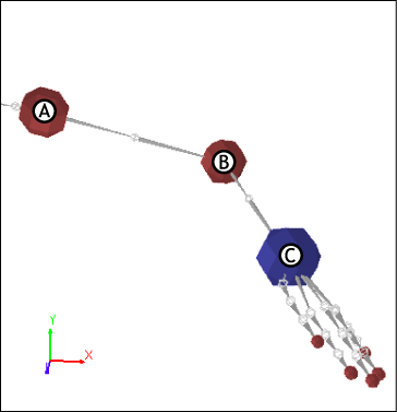

The following figure uses three joints to represent an arm. This time, it is the rotation of the wrist joint (C) that is propagated up through the elbow (B) to the shoulder (A).
IK arm chain A. Shoulder effector B. Elbow effector C. Wrist effector
Any transformation of the IK chain, even a finger tip, is propagated up through the finger joints, hand, wrist, elbow, and shoulder.

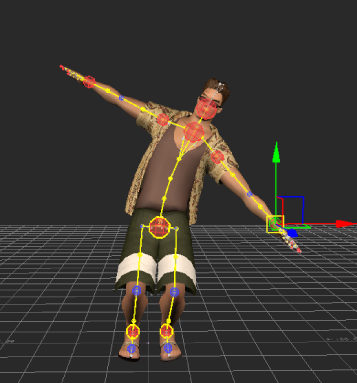

For example, the following figure shows the result of moving the left wrist effector of a character in MotionBuilder. Since the wrist effector is the end effector for the arm hierarchy, the rest of the arm and consequently the body follow and reach toward that effector.
Inverse Kinematics affects related body parts.
