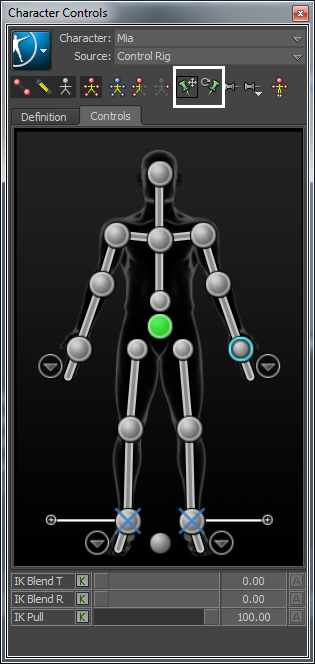

To pin a Control rig effector:
  1. Select the effector you want to pin down, then activate the Pin Translation, Pin Rotation, or both options using the buttons on the Character Controls toolbar.
To save a pinning preset:
  1. To save the Pin Translation and Pin Rotation values assigned to your control rig, click on the Character Controls toolbar and select Create Preset.
  2. In the Create Pinning Preset dialog that appears, enter the new preset name and click Ok.
    Translation and rotation pinning for all effectors is saved and can be reused on another rig. Click > Your_Rig_Name to load a saved pinning preset.
