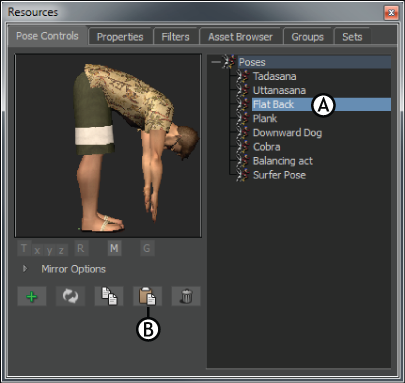

If no pose is selected in the Pose browser when you click Paste, the last pose stored in memory is pasted. A pose is stored in memory when you click Copy, Create, or Update.

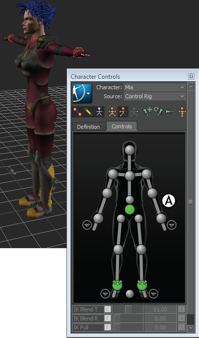

Character Controls A. Body Parts is the selected Keying mode and the character’s arms are selected
For example, in the following figure, the original pose of the character is a T-stance position. By selecting Body Parts and the left arm in the character, pasting a pose replaces only the character’s left arm position, leaving the rest of the body in a T-stance.
To paste a hand pose, select a hand effector below the wrist. The wrist is considered part of the arm body part, rather than the hand.
Pasting poses A. Select the pose B. Click Paste button C.Pose pasted onto the targeted body parts
